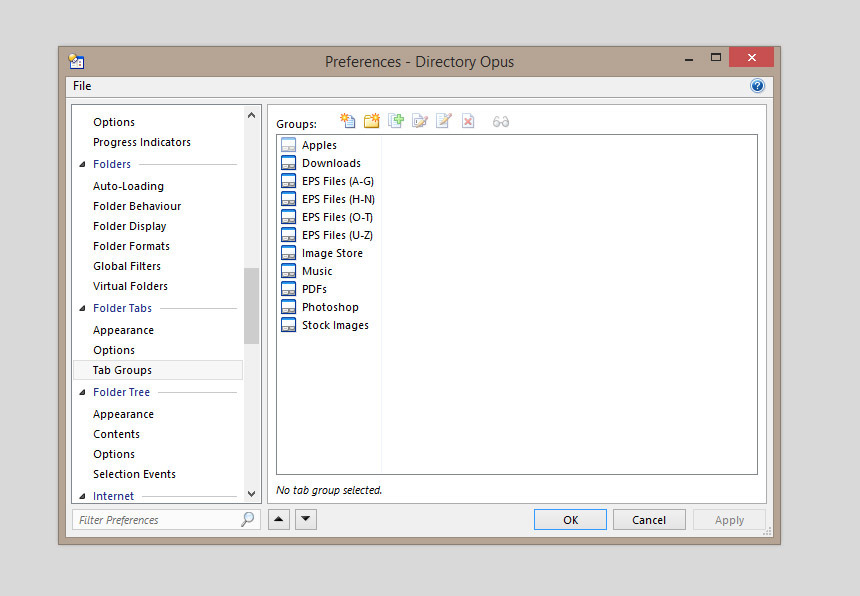

I have a number of tab groups:-
When I look at any of the tab groups apart from the first - Downloads - by hovering and right clicking over the lock, I am told correctly, that the format comes from the tab
However if I look in the same way at the Downloads tabs this is what I see:
Now I create a new Tab group called Apples to make sure it is the first tab group in the list:
I restart Dopus select the Download tab setand look at the sources of the folder format:
I can now go ahead and hide the Apples tab group and the format continues to be correct.
Maybe it is something in my set up, but I cannot inmagine what it might be.
