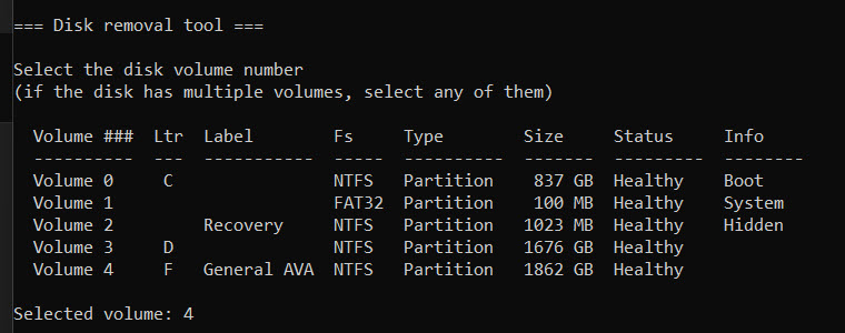

I copied your code, created a bat file, ran it as admin. It takes a 5s or so for the table to populate. I selected the correct number, hit enter, waited for the program to close. Still could not eject. Any further thoughts.
I have attached a screen shot of the program.
Thank you.
