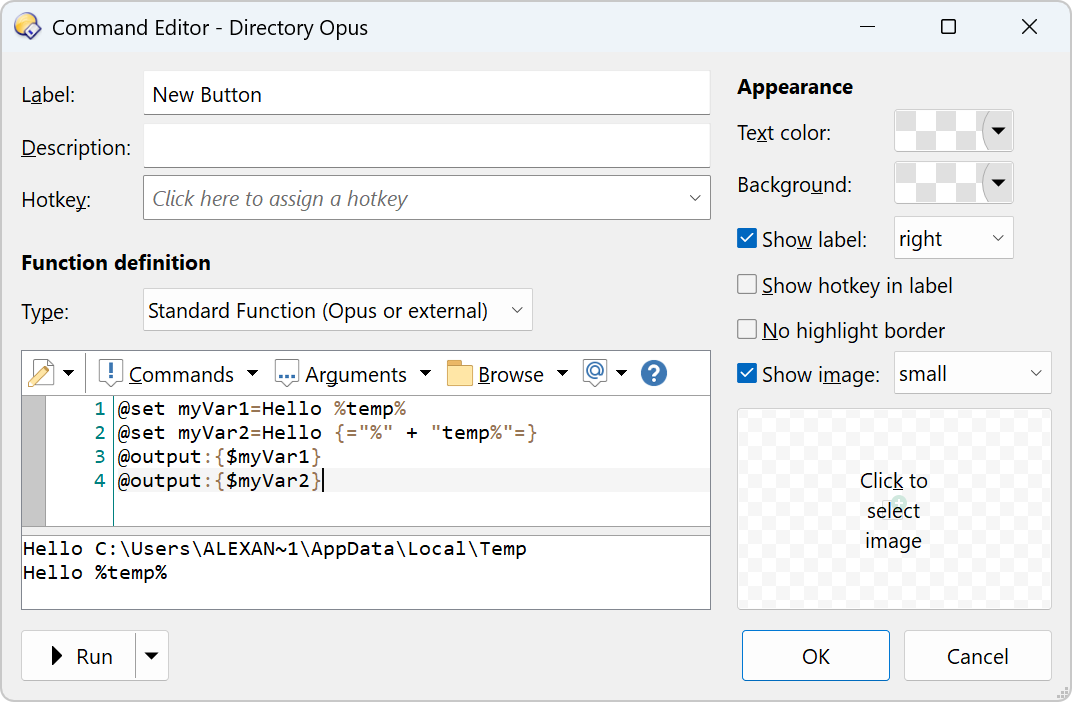

The parser fills in the placeholders and copies the rest verbatim. We can trick it like this:
@set myVar1=Hello %temp%
@set myVar2=Hello {="%" + "temp%"=}
@output:{$myVar1}
@output:{$myVar2}

For the record: This was taken back:
  • Reverted change in the previous beta to allow escaping of % characters in command lines. Potentially causes too many issues with existing commands.
So, this would make {="%"=} the best way to escape % now, it seems.
