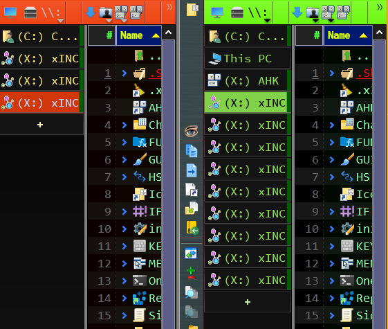

paste a file path into the box, it will open in new tab and select the file. this part works. (or use the provided notepad.exe path I put in there)
run the hotkey a few times in row, on the same file, see if it opens a new tab every time or reuses an existing one.
for me "findexisting" is ignored and a new tab is opened every time.

if only a dir is selected it will find an existing tab.
if the file is selected it will open a new tabs, ignored the other 7 i just opened.

this has been driving me crazy for a year. i have many key and menu items through ahk that get filepaths coming from various program\places\reads\clipboard etc. and opens them in dopus, with the active file selected!
i love it except as stated above, it opens a newtab every time. in this codeblock I'm testing /cmd layout by moving the args around, escaping ahk "`," etc and i have 15+ identical tabs all with the same file selected.

so =findexisting is ignored if Go points to File and Not a folder?
when send a %dir% rather than a %filepath% it stops creating new tab, but than lose selecting the file that being sent via Go "%filepath%"
Is there a way to have dopurt split the filepath down to the last %FileDir% and select the %filename%?? such as explorer.exe does with Run, explorer.exe /select, "%A_File%"
is there another command I'm unaware of the open the a dir and then select a particular file?
do i need to split that path my self to run two cmds, eg, -Go %y% then -Select %x%?
if i use Run, %dopusrt% /acmd Go "%sel%" i won't get a dozen tabs but than i losing which ever tab is active as tis change to the selected path.
well i almost anwered my question.
findexisting with a dir path works
findexising with a file path does not

You now have a new command in Opus which is called GoAndSelect and it takes one or two parameters which are DIR and (optionaly) NAME.
You can now call that function everywhere you could call any built-in function: a button, dopusrt ...
So you can go with:
Run, %dopusrt% /cmd GoAndSelect DIR="%dir%" NAME="%name%"
Why would you want to split this path?
Or do you mean you'd want that new command to be smarter and try and see if it's dealing with a folder or a file and dealing with it accordingly.
This is possible, but a little more complicated (not that much).
this is smoother than custom func thank you.
on ahk i still need to spilit the path
lets say the file is missing just sending a dir cause the parent to be opened with the dir selected, rather than opening into the last dir.
OpenToFileInDopus(path)
splitpath, path, name,dir
 if InStr(FileExist(path), "D")  ; the the path is a folder
     Run, %dopusrt% /cmd Go "%dir%" ;; so i don't end up in the parent dir? with the
else ; it's a file
this is good idea thou. ill try makiing user cmd or a .dcf in dopus to trigger
We'll make that work in the next beta.
Here is an update:
GoAndSelect.opusscriptinstall (1.4 KB)
It can now take another parameter FULLPATH, which is exclusive to the other two.
When you provide a fullpath which is:
  • A path to an existing file: it opens the tab and selects the file
  • A parh to an existing folder: it opens the tab and does no selection
  • A path to a non existing file or folder: it tries to open the parent if it exists, does nothing otherwise
