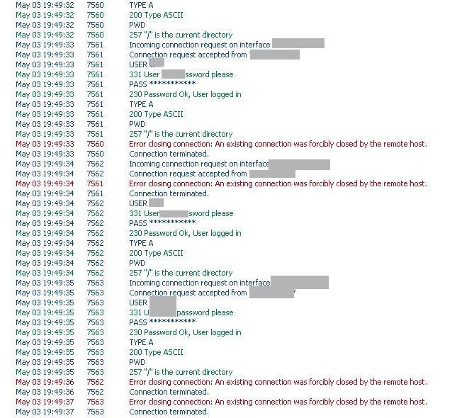

As an example from one of my connections, if I watch the FTP server's log: I constantly see the following messages (attachment)

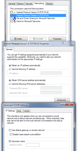

Is your VPN set as the default gateway? Try turning that off and re-connecting to it if so. (Just a wild guess, but it's caused me problems in the past with VPNs.)
I can confirm it is NOT using the default gateway. My properties look identical to yours, leo.
