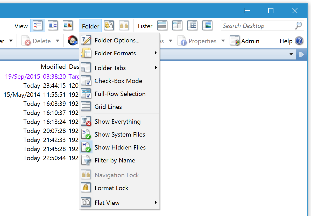

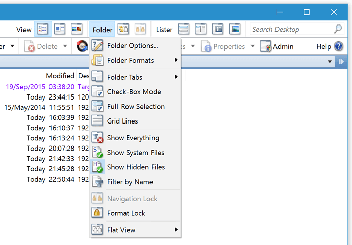

I have one question: what or where is the "default Folder menu"?
Open the preferences dialog (Settings / Preferences...), type "Folder Formats" into the search field, and the results should show you a "Folder Formats" choice in the left pane. Under that pane you'll find a series of collapsible sections in the right pane, one of which is entitled "Default Formats". That is a very powerful section that lets you tweak the default format used for various things. Editing the "Custom" option is what I was referring to in the post above. Sorry for the ambiguity. Cheers!
The "Folder" menu on the default toolbars which come with the program:
