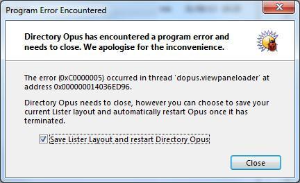

I have dragged many of the commonly used items, such as "Windows Update", from the Control Panel to one of my directories; I can use either DOpus or Windows Explorer for this task (and still can). Just recently — I'm not sure in which upgrade — DOpus crashes when I even select such a shortcut. If I'm quick, I can rightclick and perhaps read the properties, and it then stays selected, but if I then press Enter, DOpus crashes. The error message is:
This does not happen in Windows Explorer, which opens the link correctly, just as DOpus used to do. The shortcut's properties, by the way, include:

Confirmed. You can work around it for now by turning off Preferences / Viewer / Viewer Pane / Display shell icons.
That was a quick diagnosis, Doctor Jon.
  • Confirming that with this switch on, and the Viewer off, there is no problem.
  • I only turned this switch on as an experiment a week or so ago, so the problem could have arisen at any time.
The option was added in the previous 11.5.1 beta from 10 days ago.
Sorry for the crash, and thanks for reporting it. We'll get it fixed for the next beta.

Crash 1. With Version 11.5.3, DOpus is no longer crashing on items dragged from Control Panel. Thanks, Leo and Jon.
