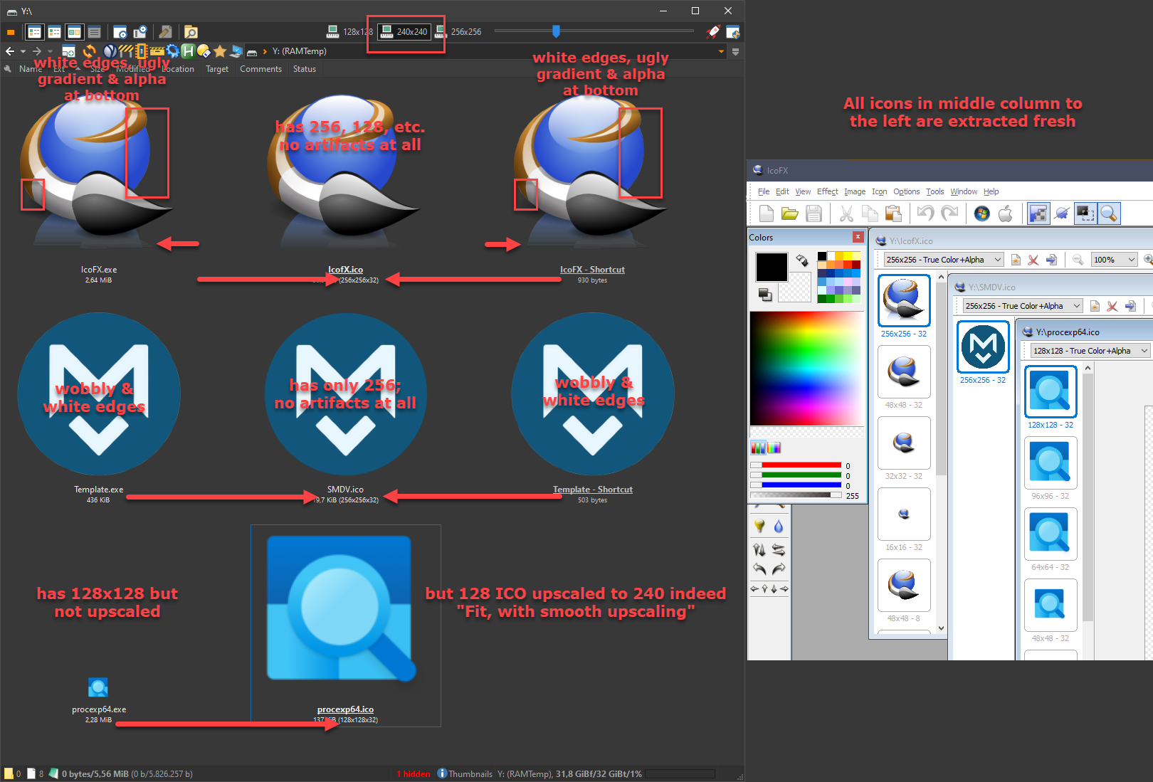

Below's a quick demo, first with DOpus then WinExplorer. H264 codec introduced some artifacts of own, but the ICOs are perfectly smooth in reality. SMDV and Run are affected most severely and instantly visible, others are mid to low level visible if you know what to look for: H2testw with shade problems, both CCleaner with white artifacts around the handles, and Autoruns with white artifacts at the top border.

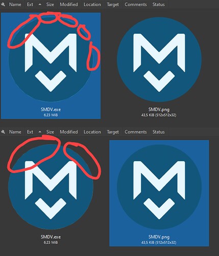

Try full-screen, most likely MP4 artifacts. Here's an enlarged screenshot of EXE vs PNG (but ICO looks identical to PNG)

Screenshots with all 5 settings. Thumbnails are around 240x240.
Screenshots.rar (444.1 KB)
I tested out all 5 over and over. They're not fixing the EXEs. And what I don't understand is, wouldn't this setting affect the PNG & ICOs too, why only EXEs?

But that is not true. I uploaded the icons above Leo, smdv icon has 1x 256x256x32b image, no other resolution or size, the run icon has more resolutions, but its problem is the semi-transparent trail on the left becoming very ugly and blocky. Also the Autohotkey EXE package has the smdv file too. Extract it with an icon editor and see for yourself if you do not believe me, or put them into an EXE yourself. All test files are above.
By the way, I have also created ICOs multiple times with IcoFX & GreenFish with multiple mid-steps 128, 64, 32, in 16 bit, 24 bit and multiple combinations. Always the same problem. When I put icons with 64x64 max for example I have no problems. It looks like somewhere during rendering DOpus loses some of the resoluton, like from 24+8 alpha bit to 16+8 or something, noticably visible on the run icon and artifacts are introduced.
These are apps I used to create, edit, extract the icons. See for yourself.
The original image is a 2048x2048 PSD, but since Windows 10 supports max 256x256 icons, I used 256 for the icon.
Since we got competely side-tracked by upscaling. Most of my files are highres, I'll rarely need it but I gave upscaling a try, too.
No matter what upscaling settings I use, if the EXEs have lowres icons in themselves, their icons are never upscaled when thumbnail size is set to higher than they support (my default is 256x256 thumbs). EXEs always stay at 16px or 32px or whatever they have. I got a couple odd 48s and 64s lying around too. Sysinternals suite has a nice mix of apps with 16 & 256 icons. I used ProcExp portable which has a 128x128 icon. So unless there are other settings I don't know of, I doubt if there's there even an upscaling for EXEs at all. But upscaling indeed applies to PNG & ICOs; smooth upscaling looks particularly great by the way, this is muuuuch better than v12!
