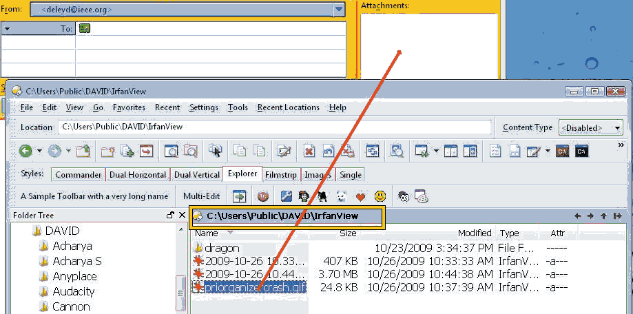

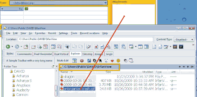

Dragging file through location bar causes delay
Whenever I drag a file and happen to drag it through the location bar (see attached image), Opus9 hangs for awhile and then recovers. Is there a way I can prevent this?
(other than not dragging the file through the location bar, as that approach only works as long as my memory lasts.)
(It's probably not called the "location bar")
