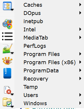

Try this button which lists folders in the C drive.

You should see this. Double click on the black triangle on the right of the folder name.
