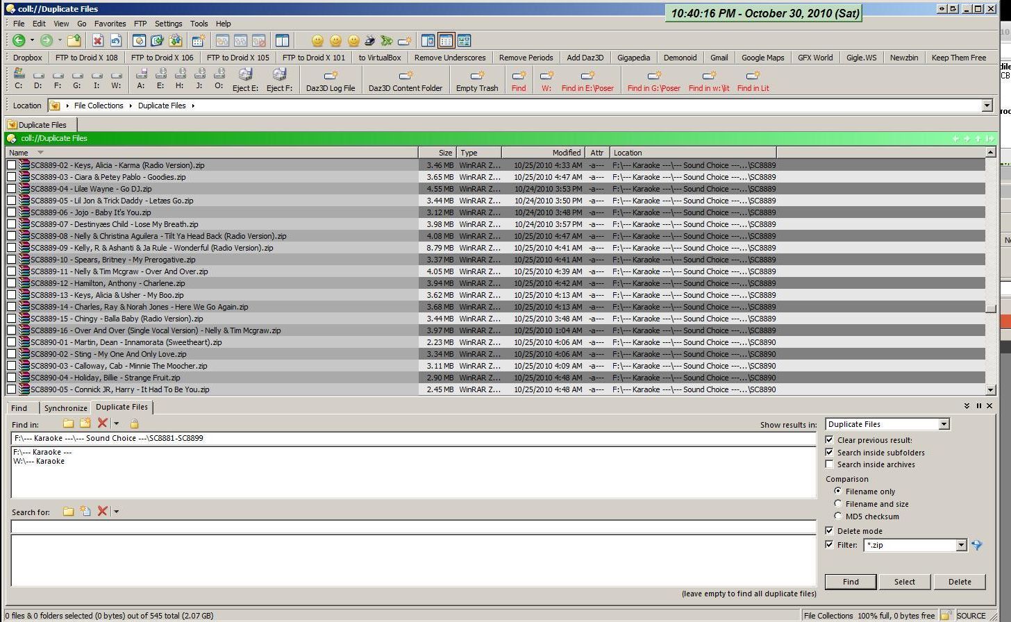

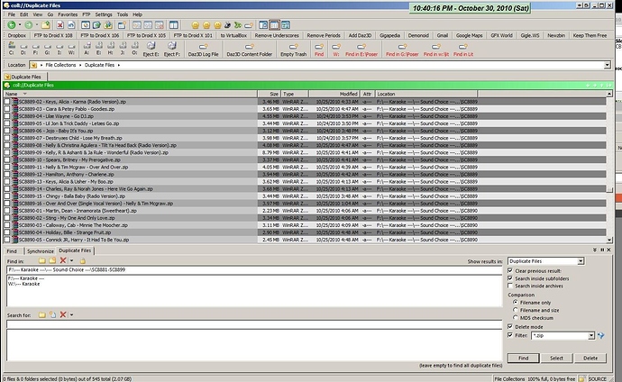

I was indeed searching by name, but it would find similar names and not identical names. Which did not serve my needs.
Can you give an example?
I'd have to make a screen movie to capture all the steps I'm going through.
But picture 1 shows the initial search.
Picture 2 shows what happens when I sort by name, and I find a bunch of unrelated - unmatched files in the bottom half of the list.
The whole thing was so bizarre I sorted through and did a lot of deleting manually. Not many left now...
My guess is that the files in the second screenshot are duplicates but the things they are duplicates of are hidden by your configuration. For example, if your window isn't set to show Hidden (or System-Hidden) files and the duplicates have those attributes set then you won't see them.
