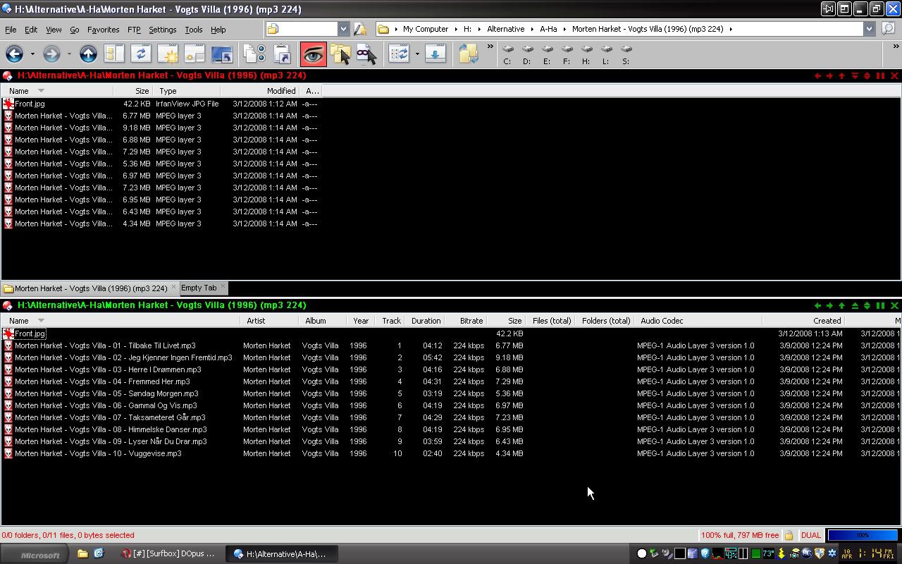

Hey Leo - format lock is indeed on. When I don't use tabs in the config, it seems to function properly, but when using empty tabs, even with format lock on, the lister formats aren't respected.
Notice in the image, the formats for both panes are identical, the bottom one without tabs displays correctly, whereas the top one with tabs, does not. Thoughts?
Have you set formats for the (empty) tabs in the style?
Note: I don't mean the overall Format option for the Style, which there's a checkbox for.
I mean the separate format for each tab which you can edit via the Tabs button in the Style editor.
If you have a Style with multiple tabs then those formats will always be used. There currently is not a way to turn them off like you can turn off the format for the Style if it doesn't have multiple tabs. (That's already been raised as an issue.)
