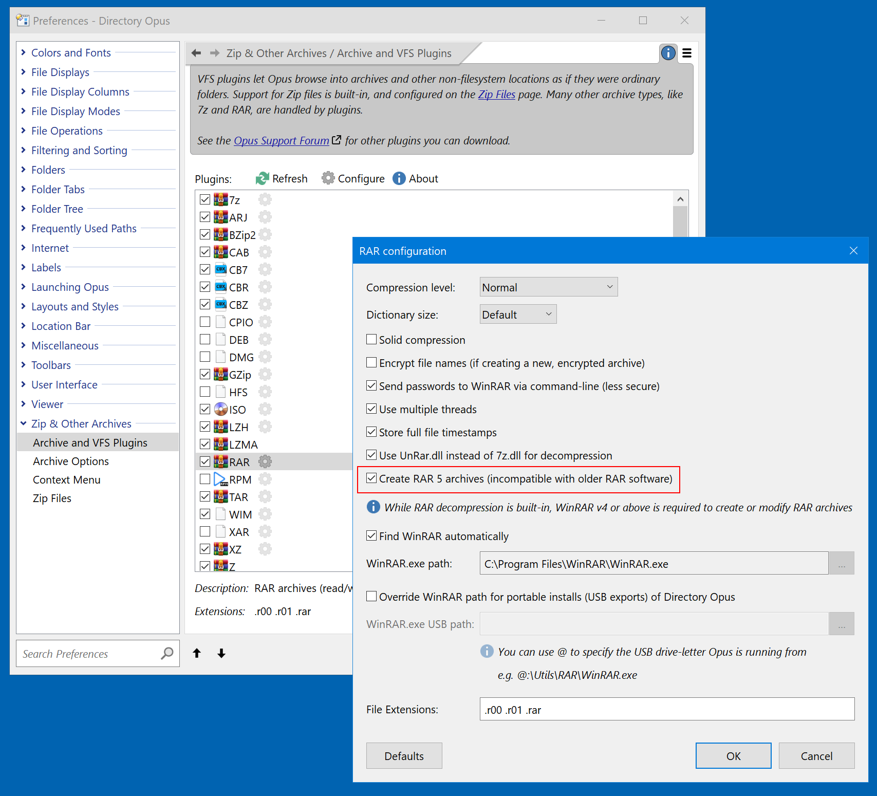

Check this setting (this should be the default nowadays)
So I see I did have WinRAR 7. I changed it back to WinRAR 6 and it works. So you are correct. That was it. Thanks
Are you saying keep v6 and do this, or for v7? Or maybe you mean do this for all versions? Thanks
You can very likely run WinRAR7 with this setting. RAR5 format has been around long enough. There is no need to keep using RAR4, especially if you are not sharing archives.
