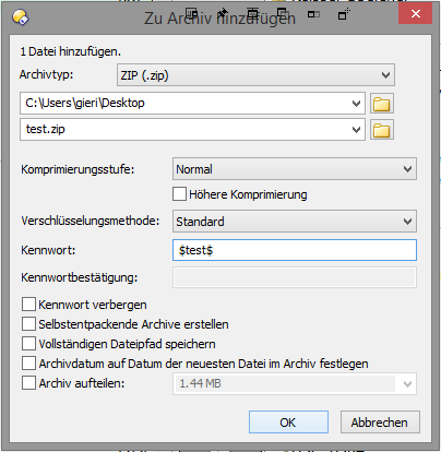

when I use Dopus to create a password secured zip file, the receiver can´t extrac it. He gets always an error message.
When I use Winrar in the same way, there is no problem.
What could it be? I use the attached configoration. May somebody can confirm this behavior?

Are the options in the screenshot tge exact ones you used? Some zip options will cause problems with tools that don't understand newer versions of the zip format, but the options in the screenshot look OK.
When creating the test zip in WinRAR, was the same password and data used? (Maybe the other end has issues with $ in passwords, for example.)

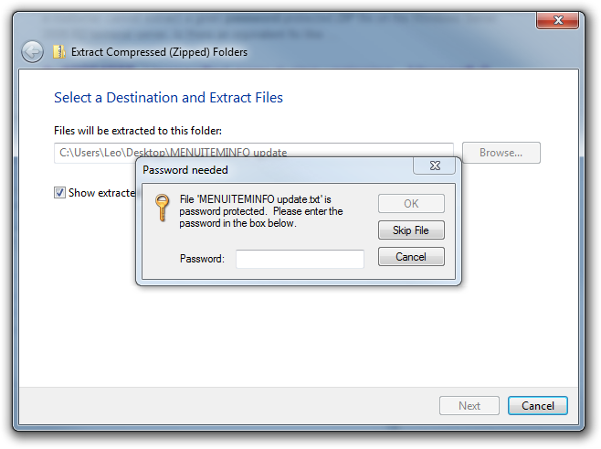

Creating a zip using the same options in your screenshot, then extracting it using Windows Explorer's "Extract..." option on Windows 7 works fine.
I also tried with your test.zip from earlier in the thread, and Explorer on Windows 7 extracts that fine as well.
So whatever is wrong seems to be a problem with the recipient's PC. I can't tell which version of Windows that is in the screenshot, so if they are running Windows Vista that might explain things. Otherwise, something weird is going on with their PC, and maybe antivirus or something is getting in the way, or some system components need repairing / re-registering.
Explorer prompts for the password like this:
