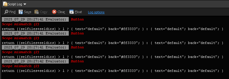

Took me some time to figure out why this error message in the console came up..
I was thinking, what "scope" is he referring to? I added some more brackets in the condition,checked the rest of the button, which does not have any real code, just toggles icon, label and colour of the button.
Some time later I was annoyed, because I wanted to use the console to see output of mine, so I checked again.. turns out, the cause of the issue was the missing bracket at the end, which emnraces the ternary "construction".
@color:= return ((selfiles+seldirs) > 1 ? { text="default"; back="#ff3333"; } : { text="default"; back="default"; } // ")" bracket missing here
Maybe there is a way to enhance on the error message or parsing a little bit?
Just an idea, because I really had no clue what the issue could have been. If you get a "scope" error message, you don't watch for brackets?! o)
