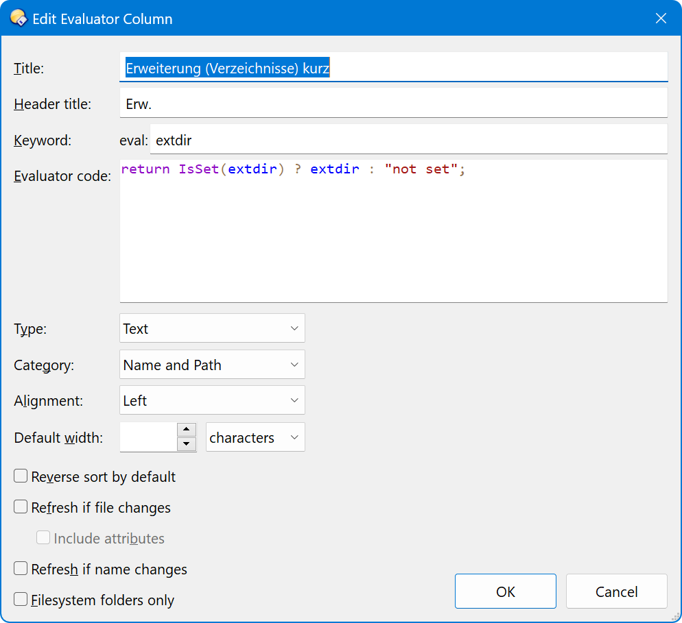

I have a similar error code whenever files without extension are displayed.
10.10.2023 19:01 Evaluator:  Error at line 1, position 1
Unknown value (6): extdir
extdir
<?xml version="1.0"?>
<evalcolumn align="0" attrrefresh="no" autorefresh="no" category="loc" foldertype="all" header="Erw." keyword="extdir" maxstars="5" namerefresh="no" reversesort="no" title="Erweiterung (Verzeichnisse) kurz" type="0">extdir</evalcolumn>
Same problem, same solution :slight_smile:
return IsSet(extdir) ? extdir : "not set";
Since it seems like this is going to be a point of confusion, we'll change it sooner rather than later (i.e. in the next beta) so that any keywords that aren't available return an empty string. You'll still be able to use IsSet() to test definitively whether they're available or not.
