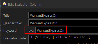

After fiddling around with creating some evaluator columns, I would like to use them in some label filter definitions.
While script columns are still available, evaluator columns are missing from drop down box:
Maybe I did not look carefully, maybe this is by intention. OTH, I would like to see evaluator columns in filter label definitions, too.

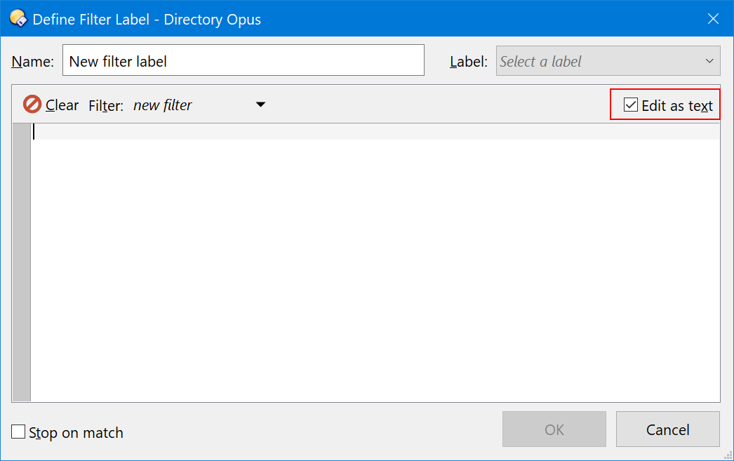

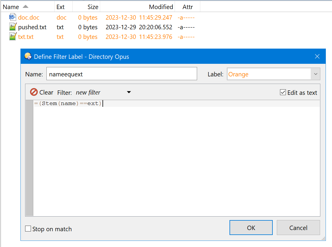

Not a bad idea, but currently you need to write pure eval code, e.g.:
Micky

WTF where did you find this kind of information? It's not available in any documentation I've searched so far.
Anyway, this does not work either: Evaluator Columns are not available as it seems.
I've got this evaluator keyword and an example file results in "yes".
When trying to use this eval in a filter, as you mentioned above
=(warrantyexpired==yes)
I get this error:
Same applies to
=(warrantyexpired=="yes")
This error does not disappear when returning a bool value (true or false) instead of a string (str) in appropriate evaluator column.

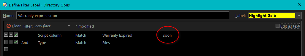

That may be true, Alex
However, when I'm not forced to use textual filters like the one above, which is mandatory for evaluator columns, I still can compare e.g. script columns results with strings like I did before trying evaluator columns:
And that's the whole story: Replace an existing JScript with an evaluator column, but obviously they are not fully backward compatible at the moment
