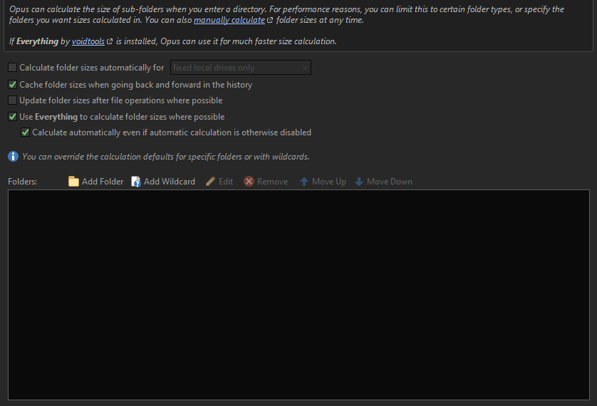

I'm very happy you added support for Everything in the new version. As of now, it's not performing well on my system. The folder size calculation is CPU intensive and slow. In comparison, Total Commander also uses the same Everything installation and is instant. I have recorded an example.

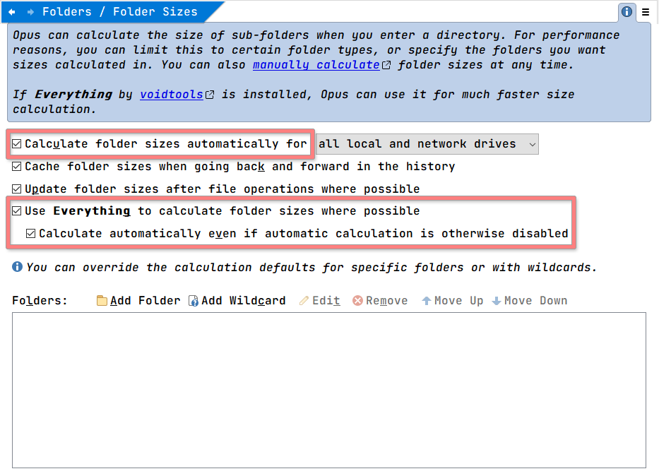

What are your settings under Preferences / Folders / Folder Sizes?
Also, when I said CPU intensive, I'm referring to the Everything process while Opus retrieves the folder sizes. It's about 50% CPU usage while Total Commander causes less than 1% for comparison. I assume that's how it's supposed to be for Opus as well.
