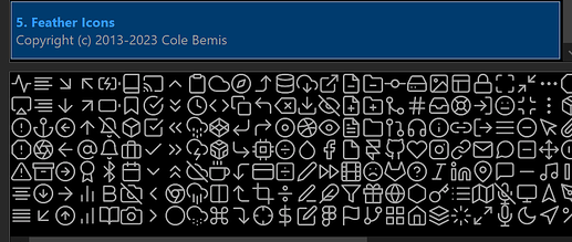

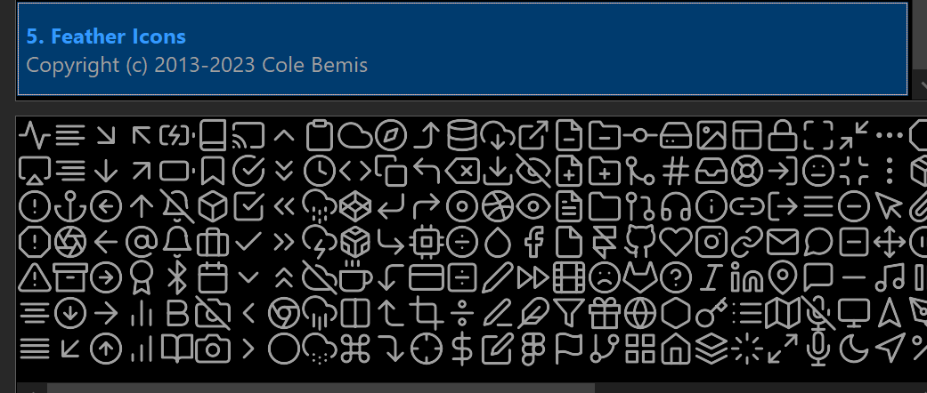

This iconset is using stroke="currentColor" in many (if not all) icons.
From a quick test, this seems to follow the light/dark mode, e.g. being some kind of white in a dark mode and some kind of black in a light mode.
Do you confirm this?
Could you point to the color (in Opus settings) this is using?
If it's actually using one of the colors in the settings, could it be possible that this becomes a dedicated color that can be set with the other colors?
and if rendered using "currentColor" in the SVG will use the toolbar's default text color automatically.
