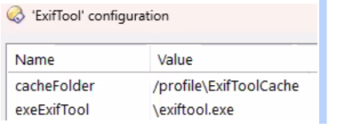

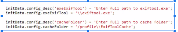

The unedited script has this path to the ExifToolCache: '/profile\ExifToolCache', so do I replace 'profile' with my user: '/megma\ExifToolCache' ?
The unedited script has this path to ExifTool:
'/programfiles\exiftool\exiftool.exe'
I have always had ExifTool.exe in my C drive, and not in my user, so should the path be edited to:
'\Exiftool.exe' ?
This is the old script shoeing the path to ExifTool.exe"
So sorry to bother you wit this!
The cache size is not a problem for the script; it accesses the cached data directly, and no search is going on. Assuming you have a large enough SSD, there is no need to worry.
You can place both the cache and the exe wherever you want; just tell the script about it in the config dialog, and the log will show you the resolved path the script uses. You are good to go if you don't see a red error message.

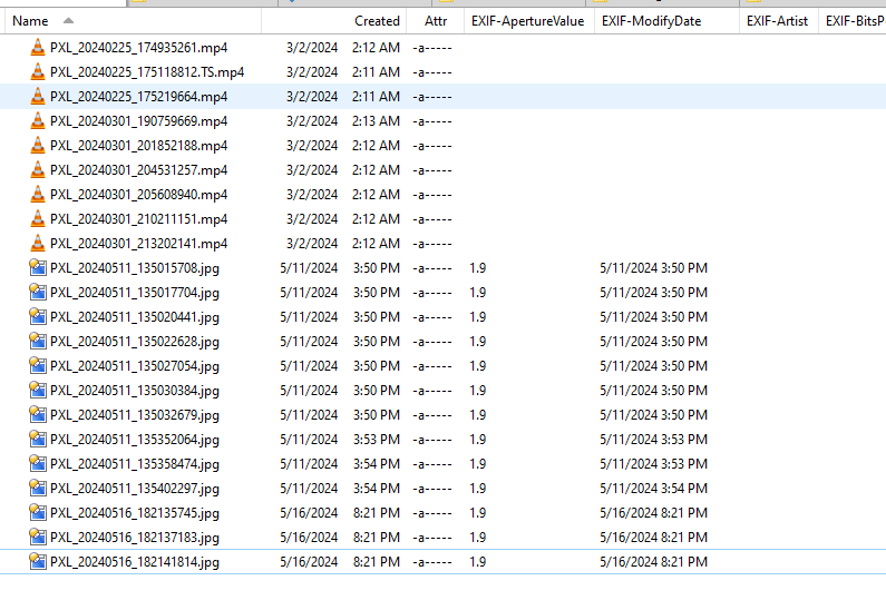

This plugin seems to work very well for almost everything, except seemingly for what I need it for.

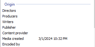

When I try to copy pictures and videos from my phone to my SSD, it always changes to modified and created date. With images, I can simply copy the take date into the modified and created. With videos, this is not as easy.
All the mp4s my phone creates have this media created data, which does contain the correct date. When I use the exiftool plugin to probe one of the files, the output gives me a bunch of fields with the date I want to insert in modified and created.
But no matter which columns I try to show, they are always all blank for all the video files, even when I have probed them and seen the data that exiftool has uncovered from them.
Not sure what is going wrong here ![]()
This is the properties view data from one of the videos,
and the metadata edit view:
Here is a view of a folder with JPGs, and the mp4s, to show the difference in data shown:
Video files rarely have data in the Exif group, try QuickTime instead, e.g.

I have found that the most reliable date field for MP4 files is Media Created or Quicktime-CreateDate (included in the Exiftool custom columns plugin). I added a Media Created column to Opus, but I don't remember how.
Changing the Date Created (date the file was created) or the Date Modified (date the file was modified) in the Properties area of the Metadata Pane may make it easier to see the date you want to see, but those dates can change depending on things you do, while the Media Created Date will not. Do not depend on the Date Created (date the file was created) or the Date Modified (date the file was modified).

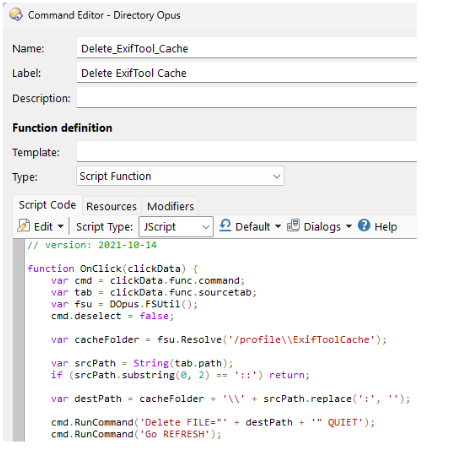

I'm really hoping someone can help me understand: I canβt delete my ExifTool cache. The button in the Exiftool toolbar does not work to delete the cache.
Is there something wrong with the path in any of these screenshots?
I made this button a long time ago to delete the cache, and it does not work either.
Please and thank you a priori for any help you can share!
The button deletes the cache for the current folder. To get rid of the entire cache delete
or any of its subfolders.
BTW: You can remove the old buttons. Their functionality is in the new script and the toolbar. They won't use the settings you make in the configuration dialog.

Please confirm: Do you mean that the button in the Tools menu of the Exiftool toolbar deletes the cache - but only for whatever folder (and its subfolders) happens to be open?
And I don't understand this:
Are you saying to navigate to that folder and delete it --or any of its subfolders?
