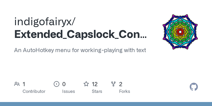

DOWNLOAD @ GITHUB
For more info and to download visit the Releases Page on the Github repo I made for Extended Capslock Menu.
Any Feedback here or as a github issue would be appreciated. there a still a few small bugs I'm working out and learning about. Input would be helpful and check for updates if you start using this menu!

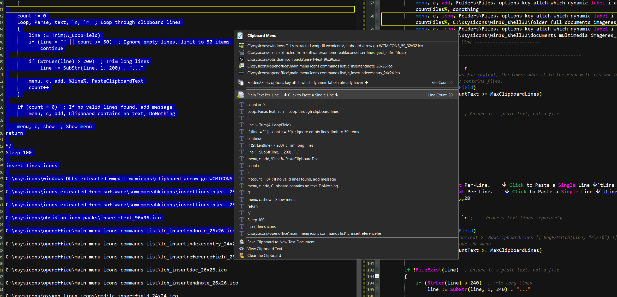

A live clipboard menu that be handle both, mixed, file paths and plain text at the same time!
can show it on it own or attached to the main.

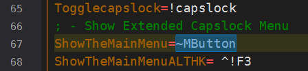

  • Middle mouse vs QAP conflict :grimacing:: The middle mouse button trigger clashes with Quick Access Popup. Any way to let us remap the trigger? Like, maybe a diff key combo, modifier or setting option to disable that?

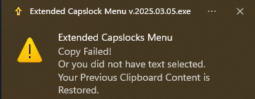

  • "Copy Failed" when no text :sweat_smile:: The error pops up if I open the menu without selecting text. Feels a lil harsh. Maybe just hide the error or show a nicer hint inside the menu instead?

Yes that button can be changed. I'm not as fancy as QAP, which I love too.
Are you using the newest version of ECLM?

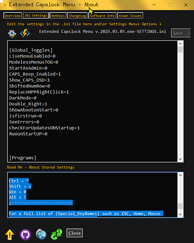

The hotkey is in the -SETTI NGS.ini file. There's a menu option that will open it it notepad. It has to be changed manually in text.
Search for ~MButton and replace it with a key of your choice. There a key to the the symbols use by auto hotkey in the comments of the [global_hotkeys] section. Save and then reload ECLM.
its only line # 67: in the settings file, Extended Capslock Menu v.2025.03.05.exe-SETTINGS.ini
You can also delete ~mbutton. I set an alternate hotkey Ctrl+Alt+F3.
i no longer use that the middle button, myself, there's a third alt key i came up.. double click the right button on the mouse. everyone knows how to double lick the left button. never seen any use a double right click because it sometimes cause conflicts with the basic right click, as mine does occasionally, thou 90% its good to go.
i put a lot to read to read in the this window.
AutoHotkey's Modifier Symbols are...
Ctrl = ^
Shift = +
Win = #
Alt = !
For a full list of {Special_KeyNames} such as ESC, Home, Mouse Buttons, Space etc... and their uses
visit the Docs page for reference.
You can use the menu to get you there. select this web address and choose " Visit Website [If a URL is Selected] " from the Find Menu our use the hotkey " Alt + Win + U "
 https://www.autohotkey.com/docs/v1/KeyList.htm
And for the error. Do you have auto-copy turn on from the settings menu?
Or from using using the capslock key? --- Which has has been remap to copy on a single tap. Paste on double tap. Shows the menu when held down for a quarter second.
To toggle the caps lock state on\off use ctrl+capslock.
And noted. I want to change that error message. I don't get it often cause I'm used to my new key layout.
I'll put an alternate to the tray tip notification on my change list.

thanks for getting my attention with your issue... I've replaced they tray tips with a quick silent tooltip
also i did update two weeks ago.... that i completely forgot to upload!!!
so there's two, significant updates at once with the update i didn't forget to upload just now! :smiley:
Hey @xavierarmand, thanks a ton for the quick reply and updates! You've totally solved my issues with the options in settings.ini. The MButton feature is also a nice - it'll be super handy for folks not using QAP. ECLM seems to make so many tasks easier than QAP, with all these extra features.
The new features in ECLM Updates are a fantastic addition, also the new tool tip message for auto-copy is smart ideaπŸ’‘.
Really appreciate your help and hard work on this tool! :clap:

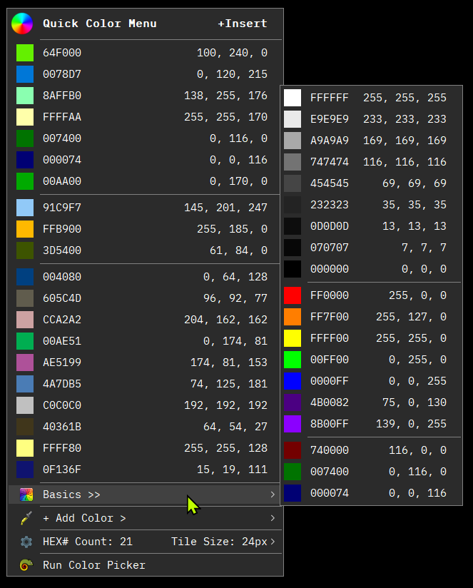

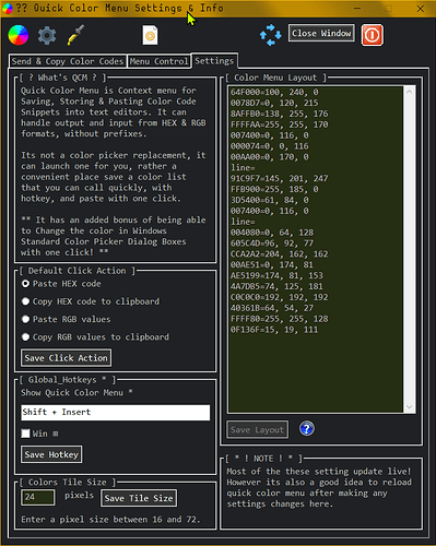

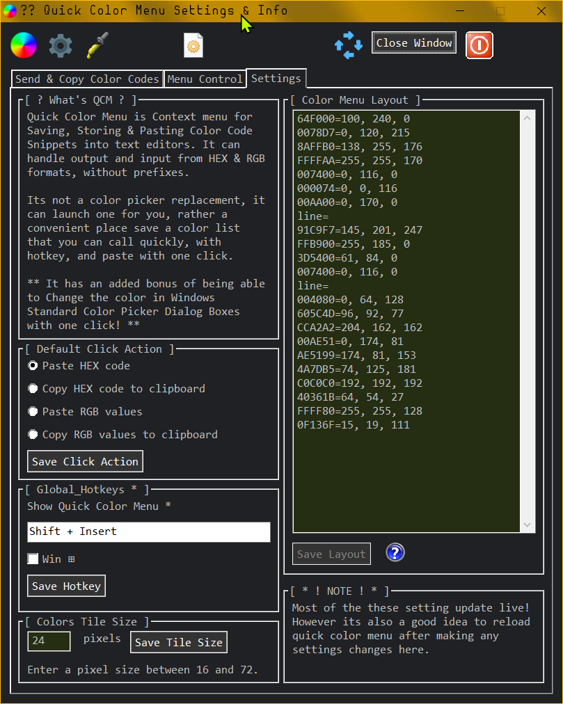

a solo snip off of ECLM i just wrote is Quick Color Menu, for saving and sending color code snippets.
its part of ECLM insert menu but i also made this its own app because i could see many theme tweakers, artist and designers find this useful on it own without it be attached to big context menu.
Nicely done! Thank you for making QCM available. It is indeed useful on its own without being attached to the big context menu, ECLM.
