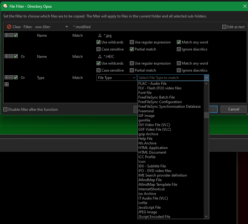

Hello,
When trying to create a filter to copy jpgs and heic files, I noticed that when choosing:
Type : Match : File Type : in the pull down list there is no HEIC (or HEIF, or RAW).
Can we add custom file types/extensions to the list to this list, or do we have to use a line such as: NAME:Match:*.HEIC ?
Thank you
The list of file types comes from the registry. Maybe there isn’t an HEIC type on your system (or it’s named something else).
You can match via the filename/extension using wildcards for the same result.
