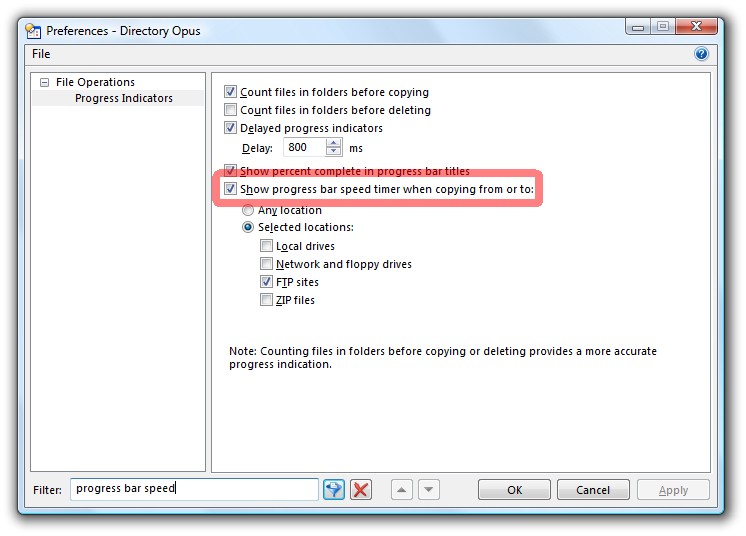

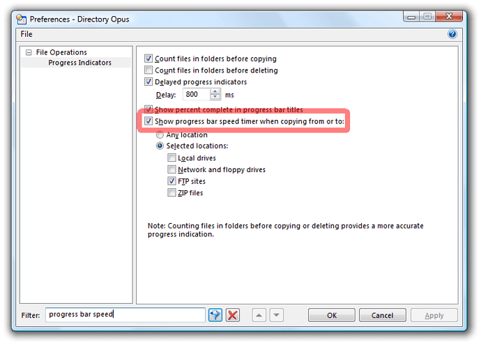

About 50% of the time when I cut/copy and paste (using right-click menu) large directories/files, I get the extremely annoying extra popup "File Function - Directory Opus" dialog.
I understand this is the default progress dialog when "progress bar speed timer" is turned off, but since I always have that option turned on (for "Any Location"), the dialog is a duplicate (and did I mention, extremely annoying).
I have tried turning "Delayed progress indicators" on and off, as well as different delay settings, but nothing seems to help much.
