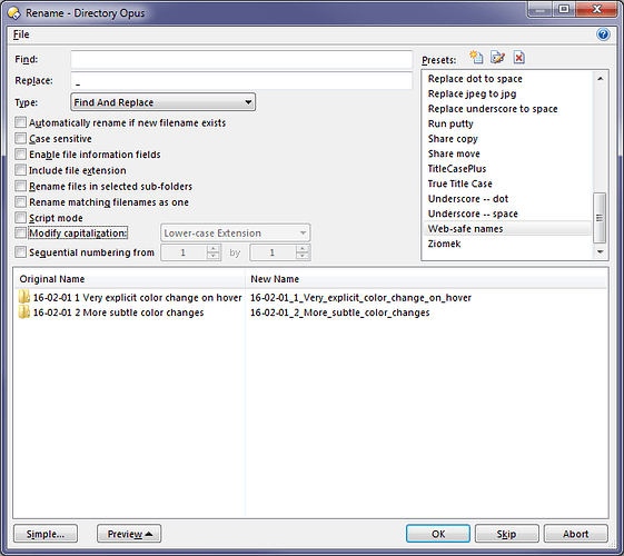

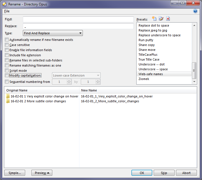

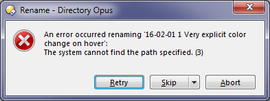

Rename dialog doesn't work on mapped network drive. What can be the cause?
My network drive is W: which is mapped to something like \RESOURCE11
I don't know any more details for now (in terms of server). Let me know if you need more information.
v. 11.17 x64

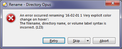

This also doesn't work (same error):
Rename TO "{clip}{file|ext}"
Oops, sorry - different error.
