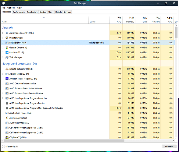

To add more see image. I forced quit the Instagram program and was left with this. That is the "Open" dialog box of course. With Chrome though I see just a "Google Chrome" and an "Open" under it not responding.
