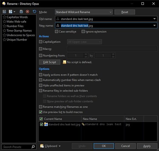

Would still like to know how to deselect 'ignore filename' by default
Append NOIGNOREEXT to the Rename ADVANCED button with which you call the dialog.

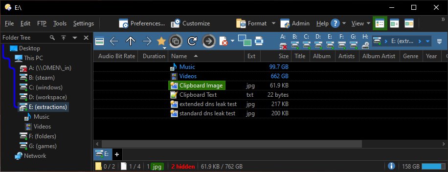

My standard lister layout does not show the file extension as part of the filename. This so I can rename a file without any interaction with the file extension.
When I want to do that I would use the rename button. For example I don't know why the extension jpeg really annoys me so I will change to jpg.

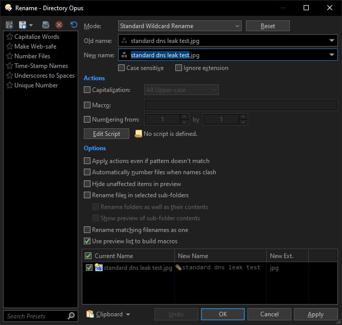

Using the standard rename button has the ignore extension box checked by default.
Using the custom rename button you provided was rectified this but when I open it by default it highlights the filename. I would like it to highlight the file extension (excluding the .) so I can just go ahead and start typing.

I don't think that's possible in the dialog.
