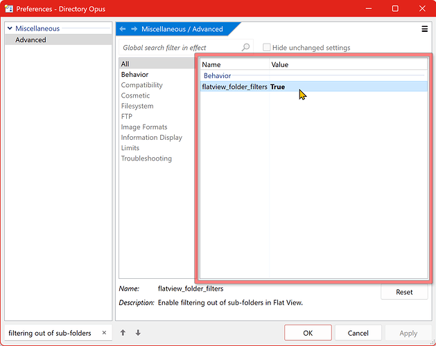

As suggested, I have now activated flatview_folder_filters=True:

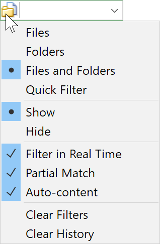

While this did work initially, now the Quick Filter Box:
...does not do anything anymore, in any view mode (i.e. not only in Flat View, but also in all other, normal view modes). Meaning, it does not filter anything.
...was I going to ask :person_tipping_hand:
I just realized that for some reason, I had another filter button (that filters for *.pdf files) which accidentally was active and interfered somehow with the Quick Filter Box. (is that the correct name for the box?)
By un-pressing that filter button everything is back to normal.
