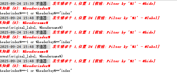

This script column,error come out. (using Filter by Column v1.8.1)
you can try it. thank you!
Did you try using quotes around the column's keyword? That should work.
I didn’t realize until recently that spaces are actually valid in a keyword...

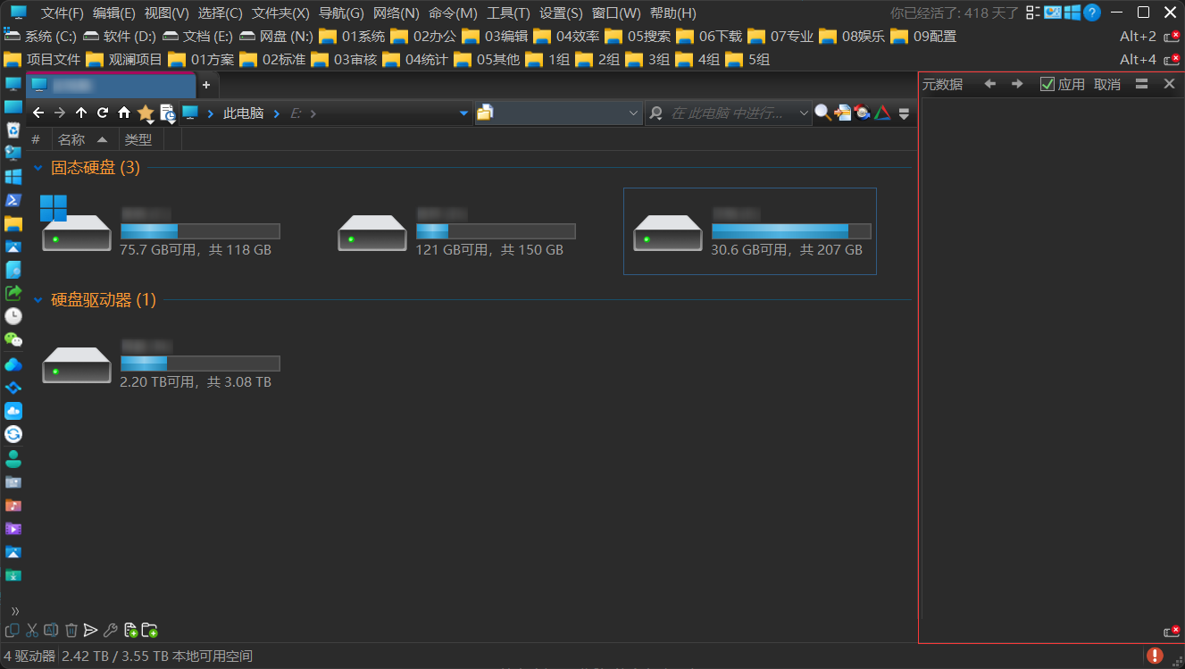

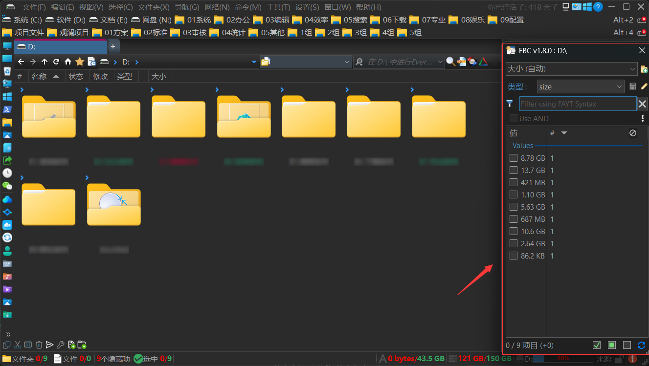

When I press F9, the meta properties window is automatically embedded to the right of the dopus main program.
wish I could embed the pop-up dialog to the right of the dopus main program, like this
Move the dopus main program window, the right panel will follow the mobile.They become a whole
Ah yes, that was by design. there's now an option to follow the active tab, so if you close or change the path, it will follow the active tab's path (if any).
That would be cool, but it's not possible at the moment. I suggested it a while ago, so you can "sign in" to the petition if you want to. Maybe that will move it up the suggestion in its list—who knows?

Every time I open DO, the error message shown in the picture below pops up.
Looks like you are calling it from the wrong place (the correct place is from the column header context menu)
