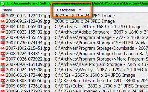

When I want to filter files by their description, I'll turn on the Description column, and then simply click on the Description column header to sort the files by description. That's all it does, sorts by the descriptions, but that's all I need it to do. However if you then select the files (descriptions) you want, it would be simple enough to hide all the others by using the
Select HIDEUNSEL NOPATTERN
command. But if you do that, you might need to use the
Select SHOWHIDDEN NOPATTERN
command to show the unselected files again.

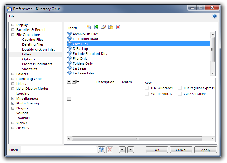

Go to Preferences / File Operations / Filters and create some filters like the one shown below.
Then create buttons like this:
Select NOPATTERN SHOWHIDDEN Select "Cow Files" FILTER FILTERFLAGS=hidenomatch
BTW, I seemed to have problems when using a wildcard for the description filter. If it doesn't work try using an exact string and turning off the "use wildcards" option, or try the regular expressions option.
