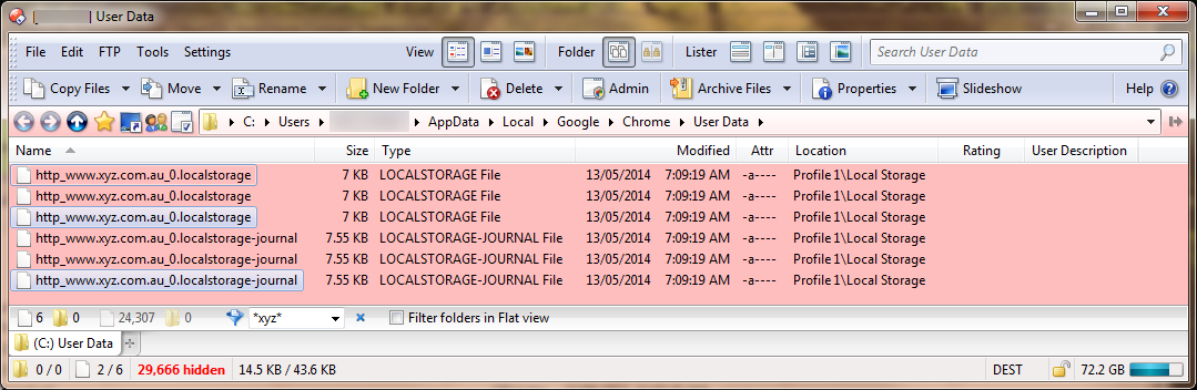

I have the following code defined on a button. Its purpose is to locate and select a pair of Chrome cookies (there are always 2 of them).
Go "/localappdata\Google\Chrome\User Data" NEW [ Set FLATVIEW=MixedNoFolders,Toggle Set QUICKFILTER *xyz* Select ALL ]
The result is consistently as shown below. The cookies are located and selected but the lister shows each cookie repeated 3 times and the total file count is shown as 6, not 2. If I execute the same Go, Set, Set, Select commands manually, one by one, the results are as expected - 2 files located, 2 files selected, 2/2 files counted.
If it helps, the 2 cookies are located quickly then very soon afterwards a duplicate pair is added to the filtered list and then a triplicate pair. The duplicates and triplicates are "phantoms". There is only one copy of each cookie.
Regards, AB

It's on the right of the image if you can scroll it or open it in a separate tab. (Scrolling works in the Android browser, though the scrollbar is almost literally invisible so you wouldn't notice it can scroll without trying.)

Jon, in answer to your earlier question, the location is Profile 1\Local Storage.
