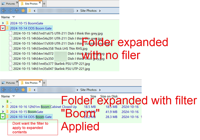

Consider the lister below.
Let us define 2 terms:
Parent location =
  • C:......\Site Photos.
  • This is the folder location that the lister shows.
Child location
  • C:......\Site Photos\2024-10-14 ODS Boom Gate
  • This is the expanded folder
In the top screenshot the Child Location has been expanded and it's contents as displayed.
The 2nd screenshot shows the same lister and expanded folder (Child Location) but with a filter applied to the Parent Location.
As you can see the filter applies to the Parent Location AND the Child Location.
Is it possible to change this so that the filter applies to the parent only?
I cannot find an option to do this..... but Opus has surprised me before!
If not perhaps it might be applied to the very long feature wish list!
