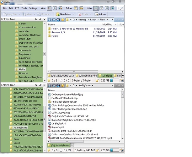

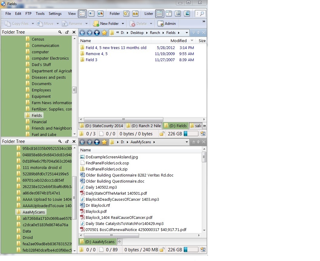

Please see example1, that is the way I run DO. Two horiz listers open, the 'utility panel' only showing the 'name matching' dialogue box. I simply activated the script you sent and shut down DO, re opened and look at example2, you will see the "utility panel" which is briefly open when DO starts, closes in about 1/2 second when the script runs, closing the 'utility panel' find function. As you can see I run the "find function", with only the "name matching" dialogue box showing, this allow more real estate for the 2 listers above. When I manually open the 'utility panel' find function I must re size it to look like E1.

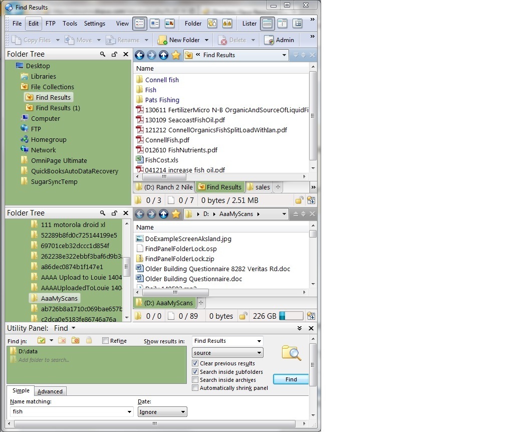

For example, close the Find panel by default (which will give you extra screen space when you are not using it), and make a button or hotkey to open it set to the folder you want it set to, as suggested as the start of the thread:
Find IN D:\Data
