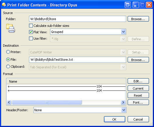

Please post a screenshot showing the Print Folder Contents window.
Here is the screen shot
Could you resize the window (or the columns) so we can see all of the columns at the bottom?
The column shown is the only column that is there.
If you're only printing one column then exactly what is it you want to have tabs separate?
I want it to indent folders, subfolders and files with only the filename and extension listed.
If you want the extension listed you will have to add the extension column to the columns to be printed. If all that is listed is the Name column then that is all that will be printed.
I'm guessing you don't know what tab-separated or comma-separated files are if that's what you're trying to do. If you want Flat-View: Grouped output to a file then output to a standard text file, not tab separated.
Tab and comma separated files are for outputting data with multiple columns which makes no sense when you only have one column defined. (It also excludes any indentation of the Flat View: Grouped filenames, at least in the current verison of Opus.)

You can't have a tab-separated file with only one column in it. The whole point is that the tabs separate the different columns - if there's only one column there is nothing to separate.
If you just want to generate an indented list of a folder and its sub-folder contents, then as Leo said, you need to select the Plain text option rather than tab or comma separated.
Thanks. That works.
