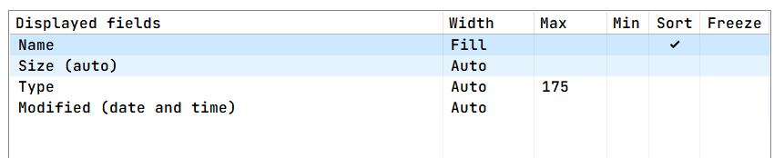

is there a way to set min column width with 'Fill' type? (and this type is a one suitable for me, no Expand or else...)

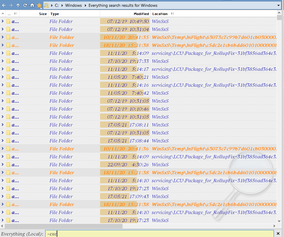

when i go to search results i always get this
I'm not sure what min=Fill would mean. Width=Fill already does the only thing I can think of that that would give you.
What is your Search Results format set to use? Or is that what's in the screenshot? (Can't see which format is in the screenshot.)
that is a search's format

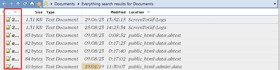

and the result in the first post - no names are visible
although 'expand=500' will be enough. I'm sorry for the trouble
Is the Location column really wide? Can't tell if there's a scrollbar as that screenshot is really cropped as well.
Screenshots of the whole window would be much better as we can see more context then.
Ah, I understand now. My fault.
I don't think you can have both Fill and a minimum at the moment, but it would definitely make sense. We'll look int o it.
