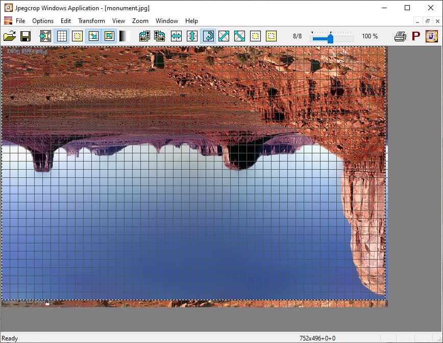

So there is no automatic solution, and the best we can do is to apply manual adjustments for each individual case.
I have integrated several options for this purpose in my Jpegcrop utility:
See also the Jpegcrop Preferences and Options description.
A special trick which I use in some cases is to manipulate the image dimensions in the SOF (Start Of Frame) marker with a Hex editor so that it completes the block size. Other than trimming, this adds more or less appropriate content depending on the encoder (the IJG encoder simply replicates the right/bottom edge to fill the block, which is mostly acceptable when becoming visible by such patch).
This dimension patch method I also use regularly with Instagram images which sometimes deviate only by one or few pixels from a standard format (1080x1350 is very common, for example, and regularly you find 1080x1349 or so).
If the deviation is more than a block size, I combine this method with the reflecting crop extension feature of jpegtran which in most cases gives pretty results.
So a number of things can be done from case to case if you know the opportunities.
