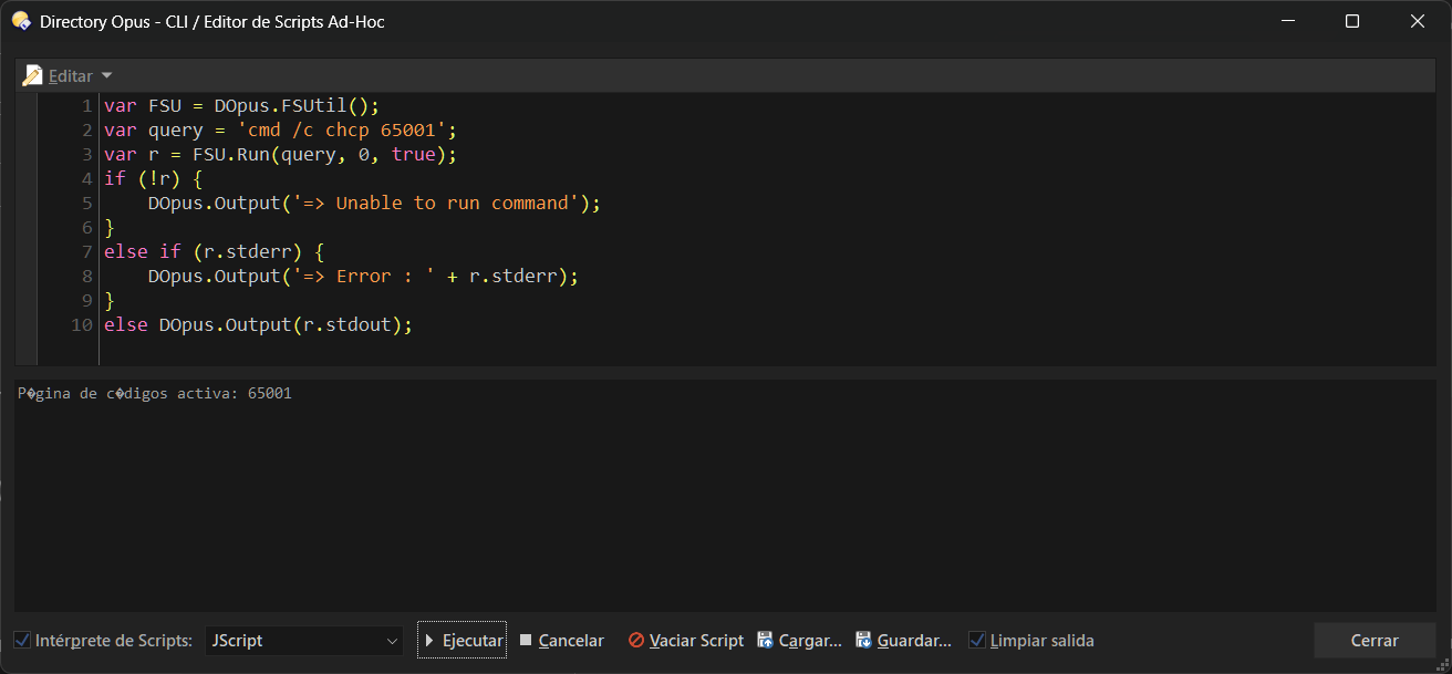

I even tried:
var FSU = DOpus.FSUtil();
var query = 'cmd /c chcp 65001';
var r = FSU.Run(query, 0, true);
if (!r) {
	DOpus.Output('=> Unable to run command');
else if (r.stderr) {
	DOpus.Output('=> Error : ' + r.stderr);
else DOpus.Output(r.stdout);
Is there's something I'm missing?
