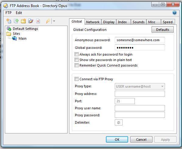

Hi,
Thought this screenshot might help.
As per our screenshot is ther correct settings.
Keeping in mind we are not having issues logging in via the mapped drives only the Main setup which we never had problems before.
Cheers,
That screenshot doesn't show anything about the site you're connecting to.
I've already given several suggestions of things to try above. Have you tried any of them? e.g. The FAQ I linked to, trying alternative FTP clients, telling us whether or not you have firewall software installed or comparing the setup of your mapped drives to that of Opus (for the FTP site you're trying to connect to, not the global settings page you're showing which is mostly irrelevant).
