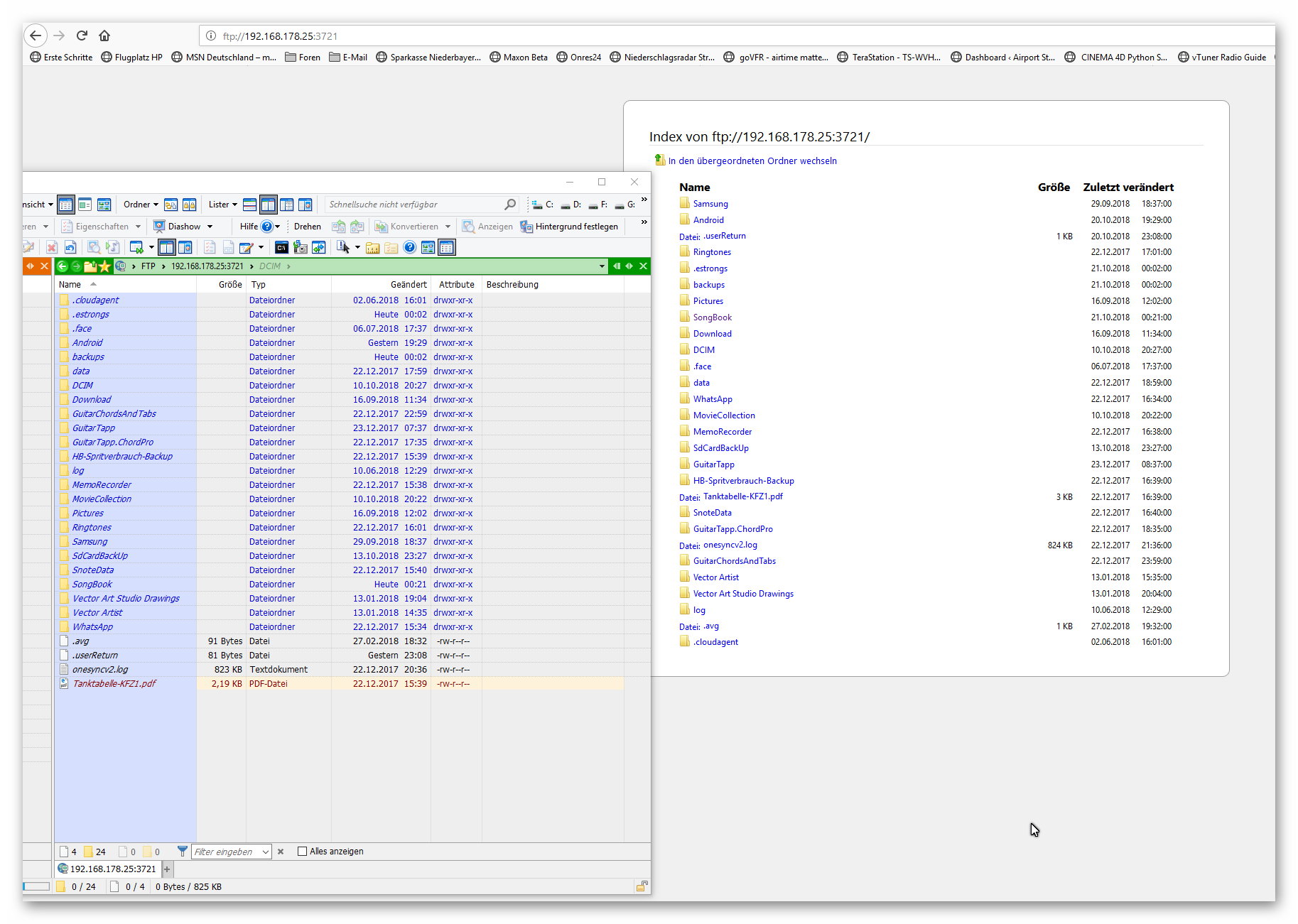

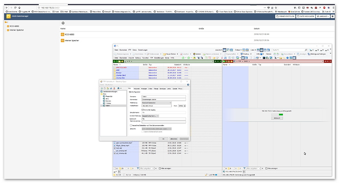

Just some pictures to clarify. You see, if I use the Asus filemanager, I get access to the card by browser, but that is with a http:// address. Opus tries and tries and gets no connection. The second shot shows if I use a different FTP app on the tablet, both, browser and opus get access, but only to internal memory, though app has set sd-card as a starting path. But this time browser has to use FTP:// adress, HTTP:// as above will show same behaviour as opus before - no connection. Hoped there is a switch for opus for different behaviour. I´m afraid Androis 7 says apps have r/w access to internal memory and SD card, but refuses to let apps really do so. I managed with another ftp to get to card by accident, but it said - and it was proved by opus I have no write access, but that´s what I need. Think I have to stick to the USB cable, that works at least..
