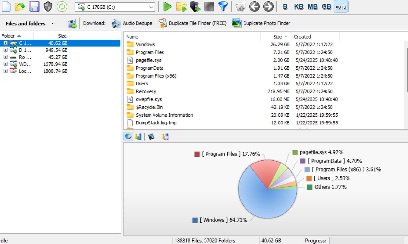

Anyhow I wondered if it is possible to setup DO close to the same as in the attached picture
I just can't figure out how to create a column behind the "size" column so it would display the size in a graph. I had it in the size column itself , or the next one over but not in a separate one.

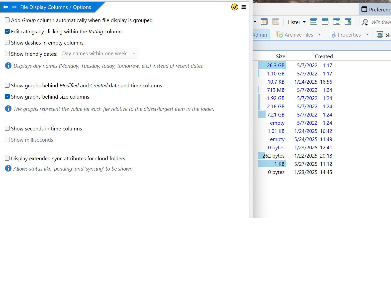

Preferences / File Display Columns / Options / Show graphs behind size columns
Thanks Leo appreciate your answer. Enclosed picture I must have somewhere a setting wrong since I have the bars in the column.
Where did I go wrong in the setting?

I thought that's what you asked for:
You can not get a pie chart behind the size column.
AFAIK, it's not possible to display a pie chart representing the space of each subfolder of a folder. That kind of feature is what you find in space analyzers.
In Opus, you'll be able to display, in the size column, the size of each subfolder and have a bar graph behind which will represent each folder size relatively to the others.
