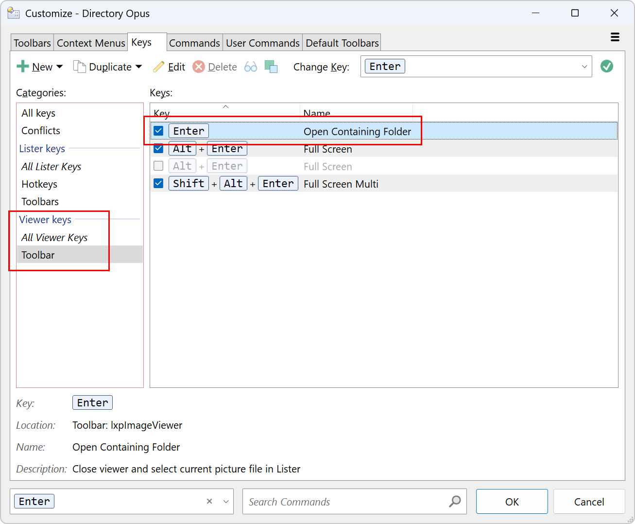

You need to add a second viewer hotkey.
(I use Enter and need no extra key to launch the viewer.)

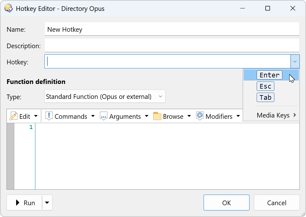

By the way, how did you get Enter to work as a hotkey? When I tried, it closed the hotkey settings window (pressed OK)

Oh, I never noticed that little down-arrow that allows you to select Enter, Esc, or TAB as hotkeys. Thanks for the tip!
