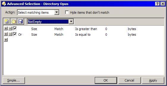

[li] We need to define a filter and save it so it can be re-used by a toolbar button that we will create in a moment. Create the filter displayed in the attached screen grab. Here's are the rules of the filter:
Size Match Is Greater Than 0 bytes Or Size Match Is Equal To 0 bytes
This will select all files and folders greater than or equal to 0 KB, leaving all folders with a size of "empty" unselected. Save this Filter, naming it: "NotEmpty" (no quotes)
