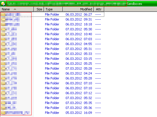

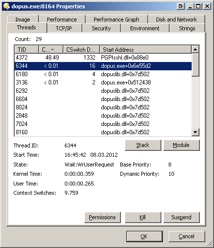

Sometimes DOpus rises to 50% system usage, i.e. one complete core on my dual-core machine. This occurs mainly when I view folders over the network. There is nothing in common when I encounter this, i.e. no special files, etc. Looking into the thread details from ProcessExplorer I see that the CPU usage is caused by a part of PGP.
Only way to reduce system usage is to complete shutdown DOpus from the taskbar icon.
PGP we use with "Whole Disc Encryption" and I cannot disable this. After some investigation I can reproduce the behaviour by accessing one particular folder. From that action I took a log by ProcessMonitor and could sent if requested.

Doesn't look like Opus is using the CPU at all there. PGP is.
I expect something turned on in your lister is causing Opus to open all the files in that folder (e.g. to populate the description or width or similar columns, or a music/video playtime counter on the status bar, or similar), and opening the files is causing PGP's disk encryption to do a lot of work.

I did see that is a PGP dll but DOpus must be triggering it somehow. Explorere does not show that behaviour. How can I pinpoint it? There is nothing special in the columns

do you really need this dll?
www.symantec.com/business/support/index?page=content&id=TECH149635
[quote="Ydex"]do you really need this dll?
www.symantec.com/business/support/index?page=content&id=TECH149635[/quote]
This is my business laptop and therefore will not tamper with the tools installed by our IT. Not in this case at least :wink:
Actually, Ydex brings up a very good point. If your organization is not using the Netshare feature of PGP Desktop, then disabling that dll will cause no harm to the way PGP Desktop functions. I've even had some customers do a customized install where the Netshare dll's are not installed at all. I would check with your admin's and show them the article that Ydex linked to, and see if they approve of disabling the dll
I unregistered the dll and it seems to be fine. Will keep on that and come back if necessary. For the time being consider this as solved. Thanks to all for the support.
