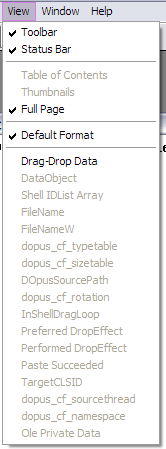

Maybe RDClip is trying to support copy/pasting files between the Remote Desktop and the local desktop and something's causing it to download the files (e.g. a clipboard monitor or clipboard history program on the local computer?).
From a quick Google it looks like Opus isn't the only thing that can trigger RDClip.exe to go a bit crazy. I've also seen it happen myself, I think when the remote computer doesn't have Opus (although the local one probably did have Opus).
Compared to Explorer, Opus does seem to make more data formats available when a file is placed in the clipboard. Maybe one of these formats is (sometimes?) causing RDClip to do something silly?
