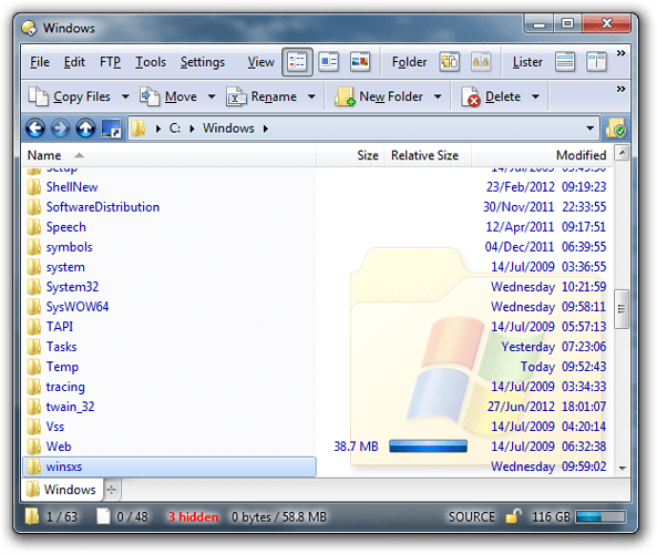

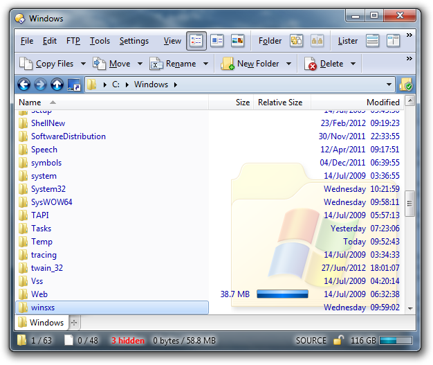

Unfortunately, all three do this:

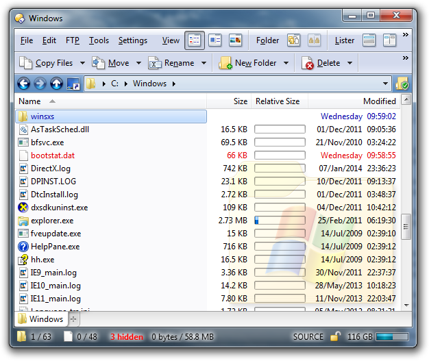

When what you probably want is this:

Interestingly, I find it makes no difference if I use MAKEVISIBLE or not - the selected item always becomes visible.
And whether it ends up at the top or bottom of the display seems to depend on where you come from. If the top of the list is shown before this command, then the selected (last) folder ends up at the bottom of the display. If the end of the list is shown, the folder ends up at the top.
Perhaps MAKEVISIBLE=top|center|bottom would be a nice feature?
I think we have a winner... all-DOpus, no flashing, no flicker. Thanks. Having the selected folder at the bottom of the lister is not an issue for me, as I usually want the lowermost folder or a few folders up.
