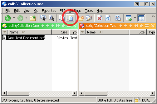

Cut & paste work on the files the collections point to, so they're not what you want. For example, if you cut a file from a collection and then paste it into a normal directory, the actual file will be moved from wherever it was to that directory.
However, there is a very easy way to move items from one collection to another:
[ul][li]Open another file display (View -> Dual Display), or another Opus window if you prefer, so that you have both collections open (one in each side/window).[/li]
[li]Select the item(s) you want to move to the other collection.[/li]
[li]Click the move button on the toolbar.[/li][/ul]
Screenshot to clarify:

[quote="leo"]
[li]Click the move button on the toolbar.[/li][/ul][/quote]
Ahh, thanks... thats pretty handy too
