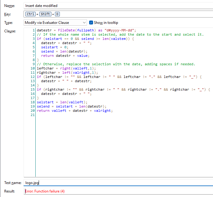

Testing this out. It works when I am renaming files "live" but the test file functionality returns an error in Preferences.
EDIT: Also getting this when I try to sample FileSize(). Other examples work fine.
This may be because the test here is just a string, not an actual file, so there is no proper evaluator context.
I think it would be better if, like the evaluator column, it allowed selecting a real file for testing.
Yes, it's just failing because there is no real file there for it to look up the date of.
