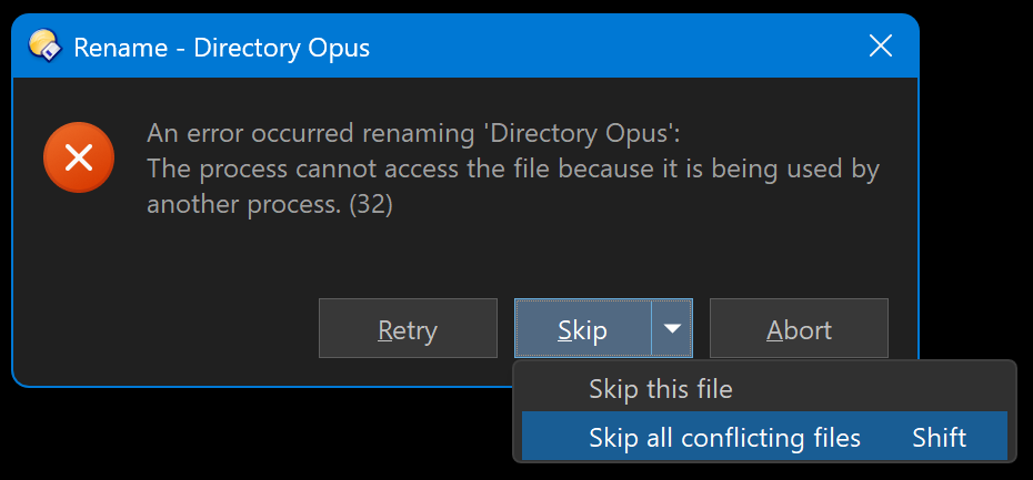

It works fine, but the only problem is that, if one or more files are locked (i.e., open in other applications) I get a dialog pop-up asking me if I want to skip the rename operation on the locked files. What I want to do is to auto-skip all locked files and proceed with renaming all unlocked files.

There's a Skip All option in the dialog:
Also accessible by holding Shift and clicking Skip.

Yes, I know about this, and I should have made it clearer in my first post. I would like to suppress this dialog entirely. The reason is that there will almost always be one or more files that are locked, so this dialog will almost always pop-up, and I will have to always repeat the exact same "Skip all conflicting files" action.
I was (still am) hoping that there is a way to completely suppress this dialog and skip all conflicting files silently, so only the unlocked ones will get renamed. Something like

Thanks, that makes sense!
We'll add a way to do that in the first beta after 12.23 is out, which should be fairly soon.
