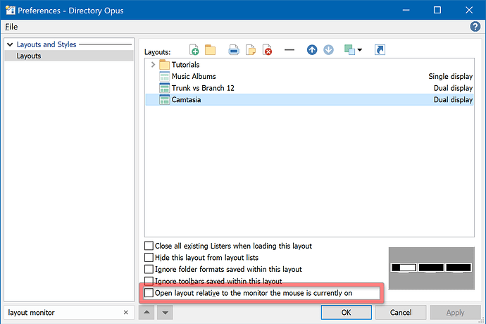

If you're opening a Layout rather than the default lister, then there's a setting in each layout which controls where it opens (you can set this when saving a new layout, as well as when editing existing layouts in Preferences):
If Open layout relative to the monitor the mouse is currently on is turned off, then the layout will open the windows exactly where they were when you saved them.
(In both cases, this assumes the monitors and screen positions still exist. If you save a layout with a window on a second monitor which is then unplugged, the window will be moved to another monitor when you open it, since it would be invisible otherwise.)
