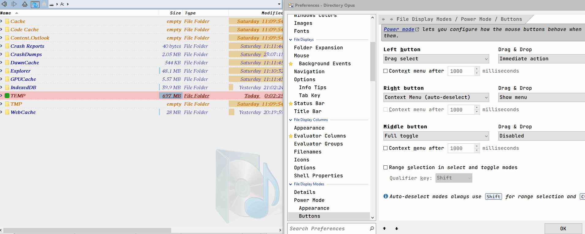

yes, i use power mode and 'drag select' for left button instead of default 'auto-deselect' because with default option there is always one selected file (can't deselect it except of additional command 'select none' or middle button [but it is turned off because my background events doesn't work with turned on middle button with 'inline rename'])
and it seems to me that this is the mode [ 'drag select' ] I've been using in DOpus for the last 30 years and I can't adjust so quickly to another.

reseted configuration. just changed left button to "drag select" and... same behaviour... only deselects selected file or drag all with one new selection. (w10 or w11 - no difference)

The only time it fails there is when you try to drag a deselected item. (And you probably don't want drag & drop and selection-toggle to be on the same mouse button as a result, but it can still work as long as you click again, if the file was already selected and the first click deselected it, then start dragging.)

in "drag select" mode i want to drag already selected files without needing to deselect them first or select an extra file. possible? (exactly as in "auto-deselect", "select only" modes but without deselection)
(I apologize for my English, maybe I explained it wrong from the very beginning)
AFAIK that isn't possible with that button mode, since the first click will deselect the file, and then you can't drag it without clicking it again to select it.
