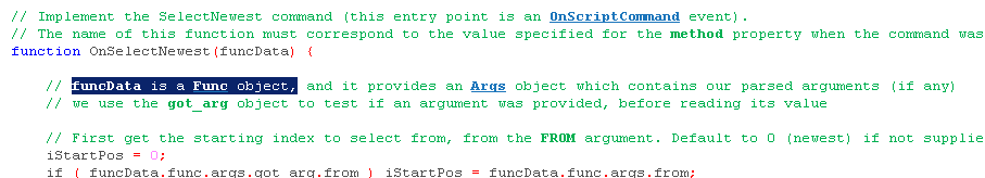

While digging the manuals, I came across this: Do you think the marked comment is correct?
Thank you guys for getting me started.. o) I'm having fun.. o)
Rob.
I've put in a help-file fix for that. It should be a ScriptCommandData object which in turn contains a Func object.
